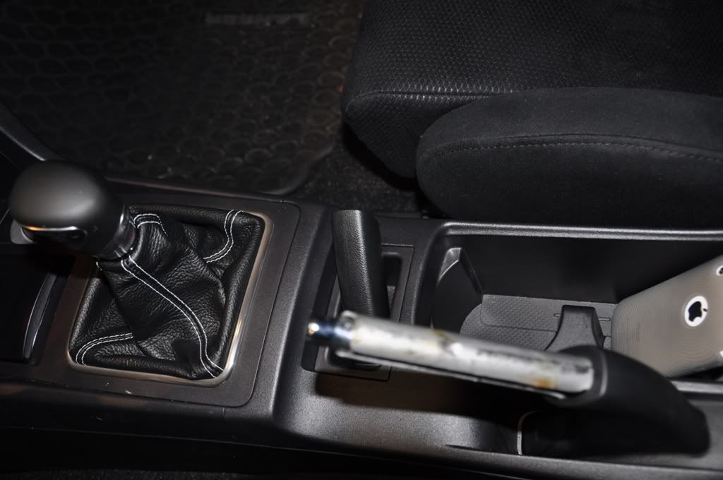

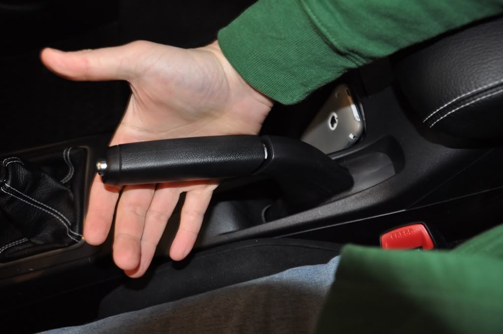

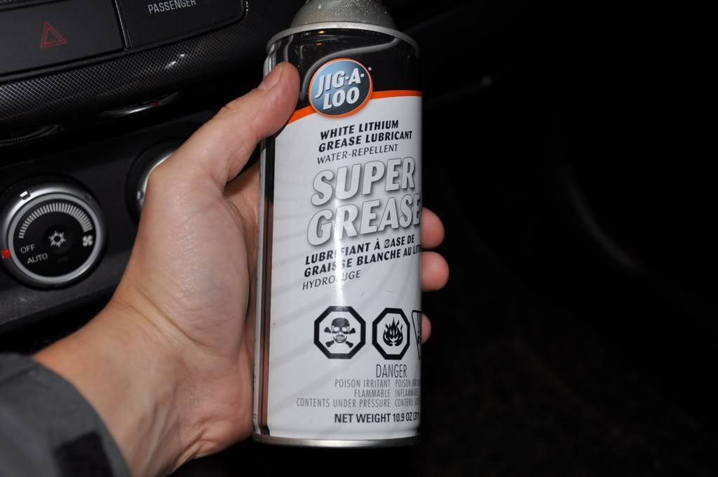

1) Slide off the e-brake handle, it takes time so be patient and keep pulling forward. Eventually it will come off. A dab of grease or pressurized silicone spray under the handle will help.

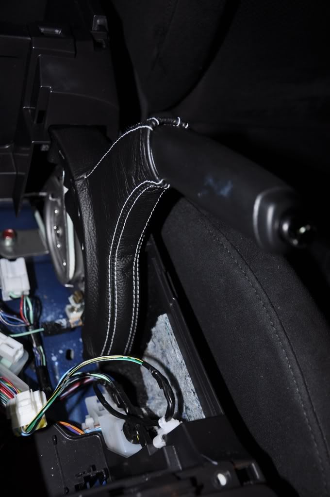

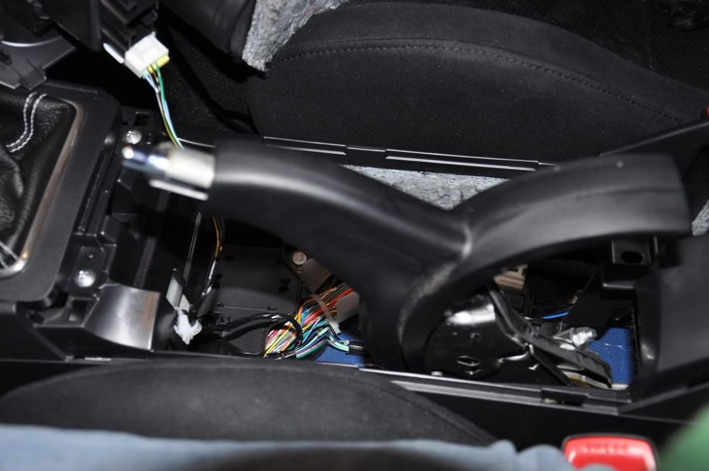

2) Open the arm rest and lift up the centre cup holder console from the rear, then slowly moving forward, pull upwards on the console near the shifter base. There are 4 clips here, ensure you don't loose the two white plastic ones near the shifter base.
3) If you have a RalliArt or an EvoX MR, Unclip the AWC module wires by depressing the white tab. If you have a EvoX GSR simply set the cup holder trim aside as there is enough slack in the wire.
4) If you have a RalliArt or an EvoX MR, Unclip the heated seat module wires by depressing the white tab, and set the console aside. If you have an EvoX GSR skip this step.
5) With the e-brake handle and the cup holder trim off remove the lower plastic e-brake boot. A little bit of force should be used to pull the lower plastic boot off.

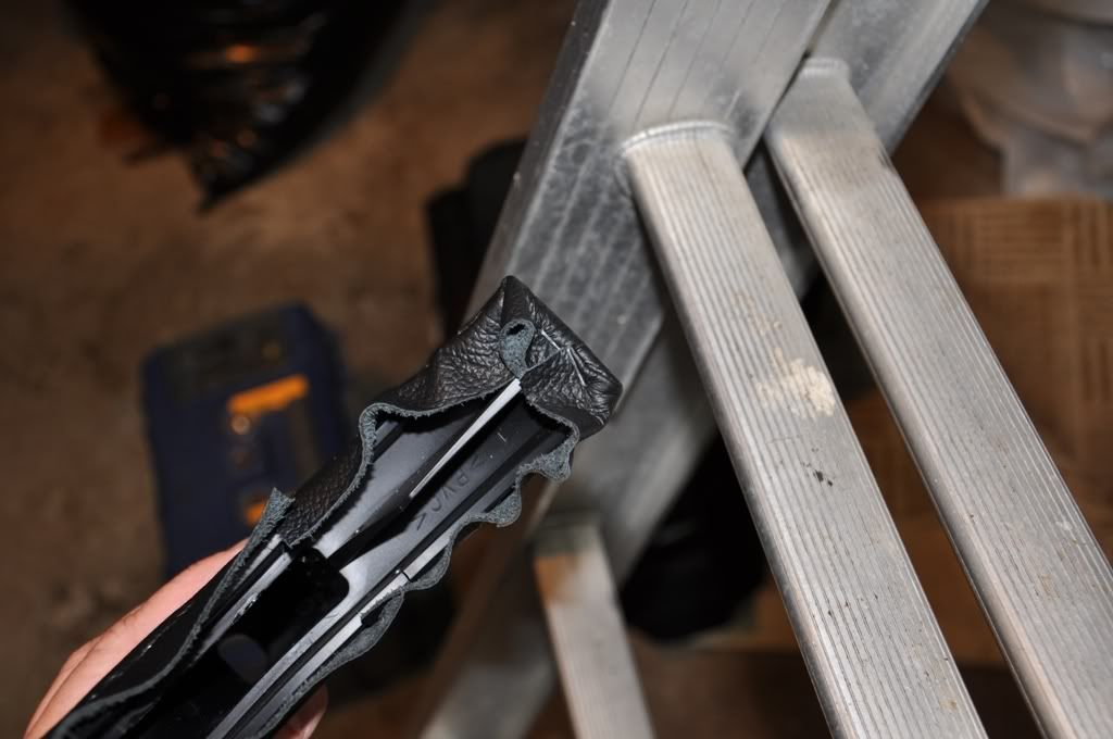

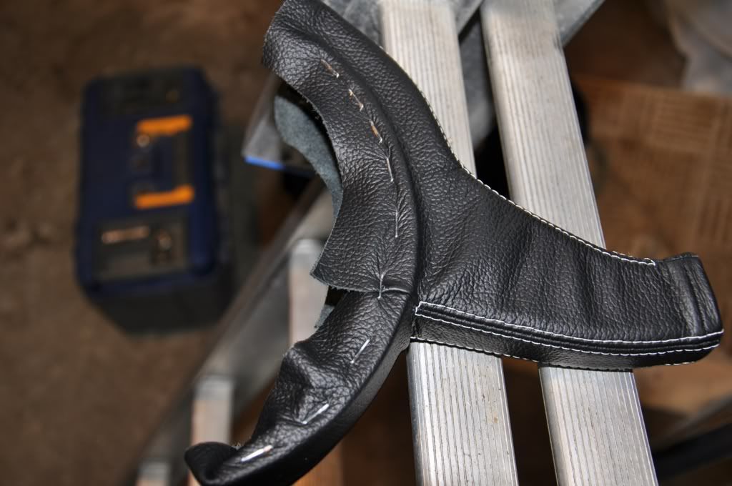

6) Slide the REDLINEGOODS leather e-brake boot over the plastic boot and staple around the lower edge of the plastic. Adjust the fit to your liking.
7) Staple the back end of the leather nice and tight around the back end of the plastic e-brake cover.
8) Re-insert the covered e-brake boot back onto the e-brake mechanism. A touch of white lithium grease should help but not necessary.

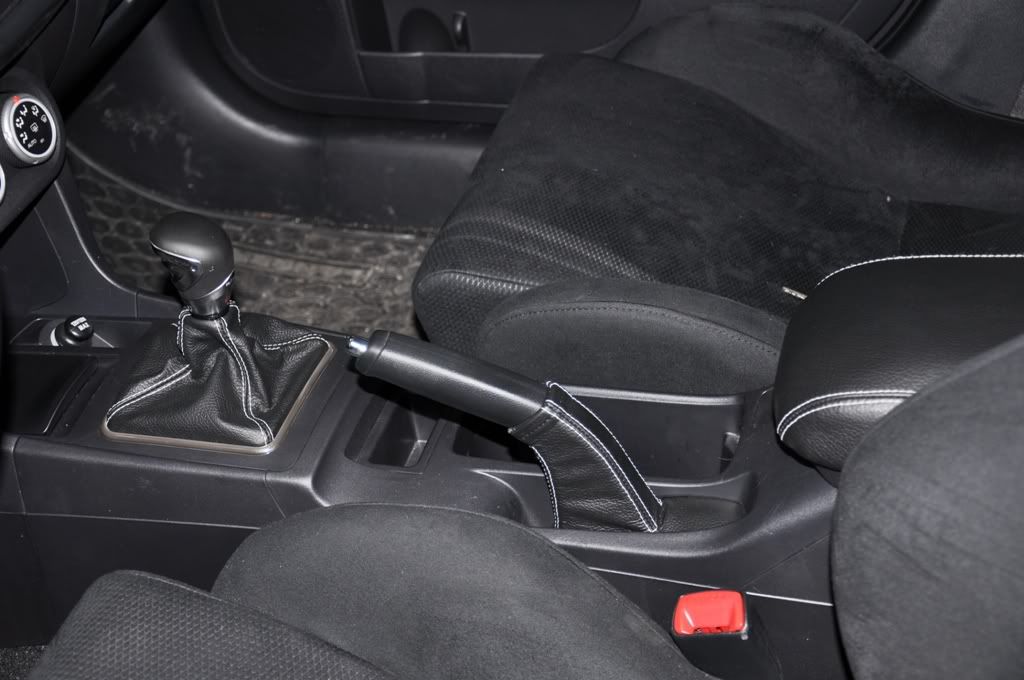

9) Re-install your plastic cup holder trim and enjoy!
CONGRATULATIONS - YOU HAVE SUCCESSFULLY INSTALLED YOUR NEW LEATHER BOOTS!
