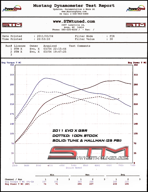

Finally got around to tuning my personal X. The only mod to the car in the base run was a set of RPF-1's (lighter than stock wheels).
I am pretty happy with it and I know there is more in it. No need to push it though, Its a lot of fun to drive now. Last year I tuned a friend of mines car that made about the same power and ran 12.2@113. Its nice to know that with just a tune these cars are capable of running 11's.
Stock: 237 HP 256 TQ
Tune: 294 HP 303 TQ
