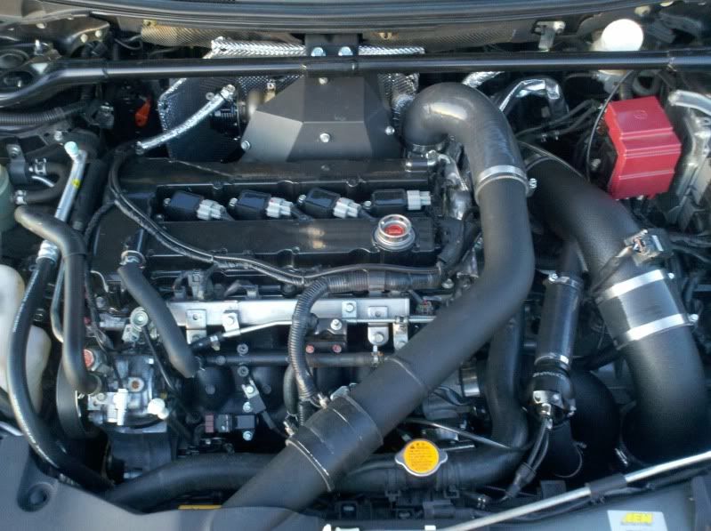

Where do you have the DV located?
See pic please, and keep in mind this is the same location with my previous turbo setup, which worked perfectly.

Have you double checked the pneumatic fittings? By chance could you PM or post for me an up close of the DV?
I can take a close up of them and shoot it to you tomorrow, but I think the valve itself is not the issue, becuase I switched back to the OEM valve and the same flutter occured.
