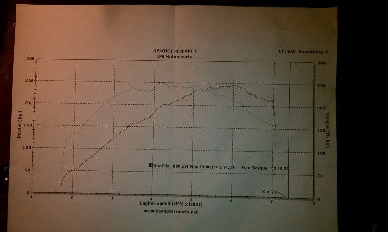

Well finally got my car on the Dyno since my install..
247whp and 249wtq
2010 Lancer GTS
2.4L
RA Turbo (7psi)
X Intercooler
Injen CAI
AMS Test Pipe
DC Sports 3" Exhaust
X Injectors
Next on the list..Evo Cams -- Hopefully by the end of summer.

If I had it all over again I wouldnt have but I did, and its a done deal now haha. This is my first Forced Induction build..so Ive learned some things to do and not to do with my next car. Its been a good learning experience, but no where near my last build. I was happy with the numbers, rated 169hp at the crank NA..so it is a pretty nice increase.

ya definitely a nice increase... prolly 100 or so whp. What is the RA turbo like compared to the RoadRace turbo kit for performance?

Well they both run at 7psi, I think the RRM turbo performs closer to the X turbo. Mine spools pretty low which I like. I am a bigger fan of the fact that I am running a good quality OEM part on my car. And I built my kit for half the price RRM charges.
