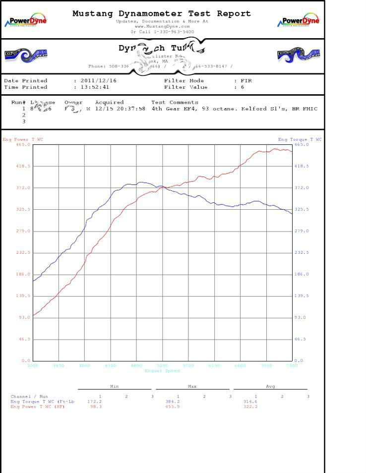

My buddy just got tuned in Seekonk MA, He's not on this forum, Not really a forum guy. But he wanted me to post up some results since he is very happy with the new MAP EF4 Turbo. He was wating for this turbo fo a long time and was almost scared when he took his first ride. He had a shop try to tune his stock turbo and it made 210 to the wheels, so after some work he got re tuned to 361 whp on the stock turbo. Ofcouse it wasnt enough so he purchased the EF4 and had excelent results. After the winter he will Fully build the block, go with a double pumper and FIC 2150's since he already was running out of fuel at 450 hp. He plans to go e85 next year as well.
So far with 93 Pump gas 455hp/384tq on a Mustang Dyno
Mods:
MAP EF4 un ported
Buschur FMIC
FIC 900cc
Walbro 255
3" TBE
Hallman MBC
K&N Intake Filter
GSC S1 Cams <graph says Kelford but they are GSC

Were all friends. Do you have any? A lot of people have wanted results on the new EF line of Turbos. So here are some results. The turbo performs very well with minor bolt on upgrades. As you can see it keeps making power. If the car didn't run out of fuel and we could rev to 8k it would be a solid 500 AWHP street car. So for now everyone is pretty impressed. Everyone can even buy them from you if you so but hurt. I actually blurred out anything on the graph for advertising. It just hasn't taken effect yet for some reason.

Thatd be great. Nice results regardless.
Seems a bit high for a stock block.

Stock Block, Stock head. Just s1's.
Would love to run this car on a Dyno Dynamics to see how they compare. Lots of people like to compare Dynos these days

Just FYI if you were intending to "blank out" the shop name (come on, we MA guys know who it is lol) you left big ass lettering on it in the center there.. and the side logos aren't blanked out very well. But I know there are dozens in Seekonk MA...hard to tell which the graph came from ;)
Just busting your chops. Great numbers on an EF4. I've been following this one lately, seems like it's gaining some traction.

Remember, numbers between dynos aren't as meaningful as baseline comparison on the same car with new mods and tune.

I'll do a better job of being secret, although I do like to point out parts that work, and work pretty well. And yes it was all Blanked out. If you recognized the logo its not my fault. And people might want to know more info about the build. We are all into the same addiction here and should be able to spread the knowledge and work together.
