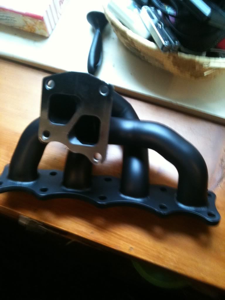

Well, in preparation for my track day this upcoming Friday at Roebling Raceway. I have wrapped my MAP Shortrunner exhaust mani. I managed to do it (extremely painfully) with the manifold still attached to the car. If all my tools weren't at a friends house, I probably would have removed the manifold myself and done a better job. Nevertheless I think it turned out acceptably and should result in some cooler temps in the engine bay.
On my first drive after installing it, I suspected it might smoke a bit since the label indicates so. What I didn't know is how much it would, I was sitting at a stop light in some girl in a honda was trying to inform me (as if I wouldn't notice) about the giant cloud of white smoke slowly floating out from under my hood accompanied by a very distinct burning smell. After about 10 minutes it went away fortunately :). It actually smells pretty...good :D
And when you don't have tools...improvise! This installation was painfully completed with 1 steak knife, 1 butter knife, 1 needle nose pliers, and 1 wire cutter!
Complete with heat shields back on:

Did you reuse the OEM double washers on the manifold?
If you did not, then that's your problem.
If you did, then you didn't install them correctly. The 2 washers are actually concave and your supposed to install them one with the belly up and the other one down.
5,820 Posts
The Shortrunner comes with a stud & nut pack, it is not compatible with the stock mounting hardware. I didn't do the install, a friend of mine who has been a tech for quite a while did.
