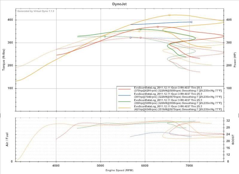

I'm a noob when it comes to tunes & datalogging. I did a few pulls last Saturday and logged them and I'm trying to figure out if there are any issues with the car and if the current tune is good for DD. Anything else that may be helpful based on the info provided would be appreciated. Suggestions for what the next steps with the car should be and in particular tuning advice. Looking at the pulls in virtual dyno there's a lot of variation between the logs. Maybe it's my driving, maybe it's the tune, maybe I'm not doing something right with how I'm logging or something wrong with my settings in virtual dyno. Some of the runs wouldn't load in virtual dyno and I got a message saying
I've attached the logs, the dyno sheet & the MAP

You need to clean up your logs...and then maybe consistently start your pulls at the same RPM...2k perhaps.
1,103 Posts
Virtual dyno reads from WOT (80% throttle) only, your in and out of the WOT so it looks like a slinky. Usually do third gear and go from 2000-7000. Try and stop and start the logging relative to the run.

Yea some of the pulls that I did wouldn't even load in virtual dyno. My bro in law was pressing the start/stop and It seems like he wasn't in sync with my driving. I thought I was putting my foot to the floor each time he was logging so not sure what's going on with it not reading WOT. I was shifting into 4th somewhere before 8k each pull and then letting off in 4th.

Your PM is in the Queue. You purchased a car from another owner who I had a tuning relationship with.I did take a quick look at your logs and you need to log less items to get proper logs to really see how the car is running. From the low resolution logs it looks like things are working correctly still.

I appreciate you looking at the logs and I will definitely do a better job of logging next time so that the pulls are more consistant and that I only
log a few of the key paramaters. How many would you say is a good amount and which ones are most important?
Obviously afr, boost, timing, coolant temp, oil press, knock, throttle, injector duty cycle, any others?
