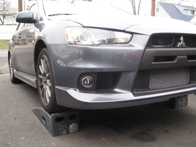

-In this tutorial, we will only focus on the passenger side. Both sides are the same. Keep in mind though, that this picture may slightly vary from what you have. This car has an Aero Kit on it. Do one side at a time, so you can't mess up of what clip goes where if you need a reference.

1 - Start by getting the front end of your car elevated. It's up to you to do this in a safe manner. Ramps, jacks, will power.

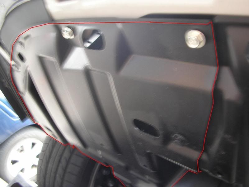

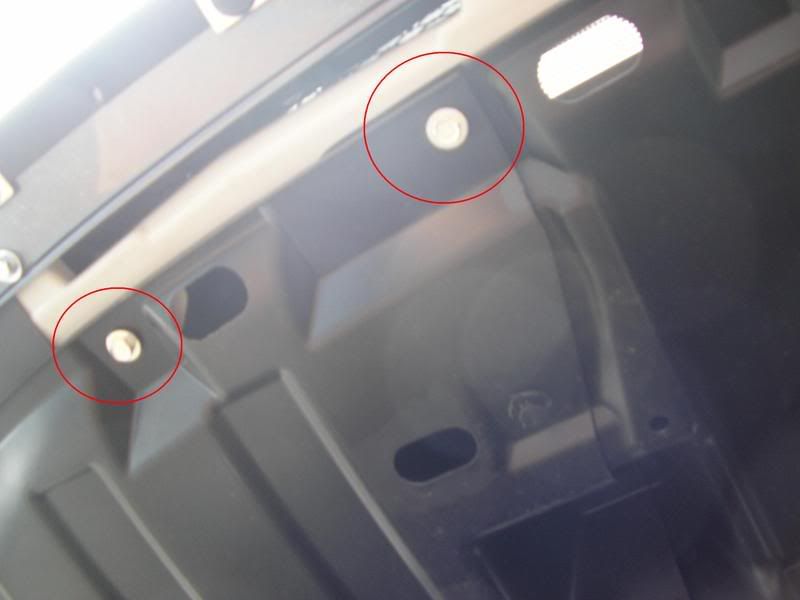

2 - Take out the 2 x 10mm bolts on the front end.
3 - Take out the plastic spreader clips with your (-) flathead screwdriver. Do it slow, these clips are "strength in numbers" only. There is one clip that may seem hard to get to, but it's not. Its tucked away, but with enough room to get your flathead in there.
4 - Take out the lower plastic panel to reveal the fog light.

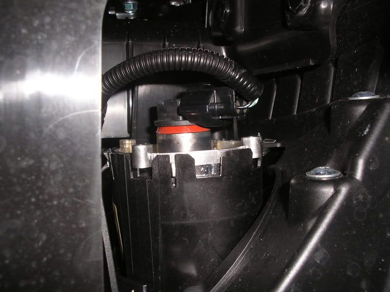

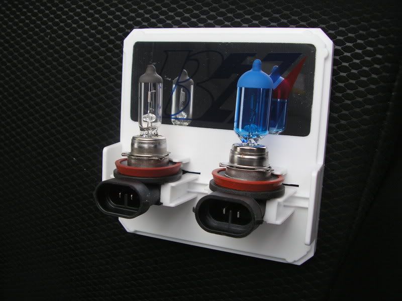

5 - Rotate the light bulb counter clockwise and pull out. It only turns a little bit as shown.
6 - Replace the bulb with the one you purchased.
***Remember*** Do Not touch the bulbs. Either you will get burned from the stock ones, or your greasy fingers will leave a residue that once heated will crack and blow out your new bulbs.

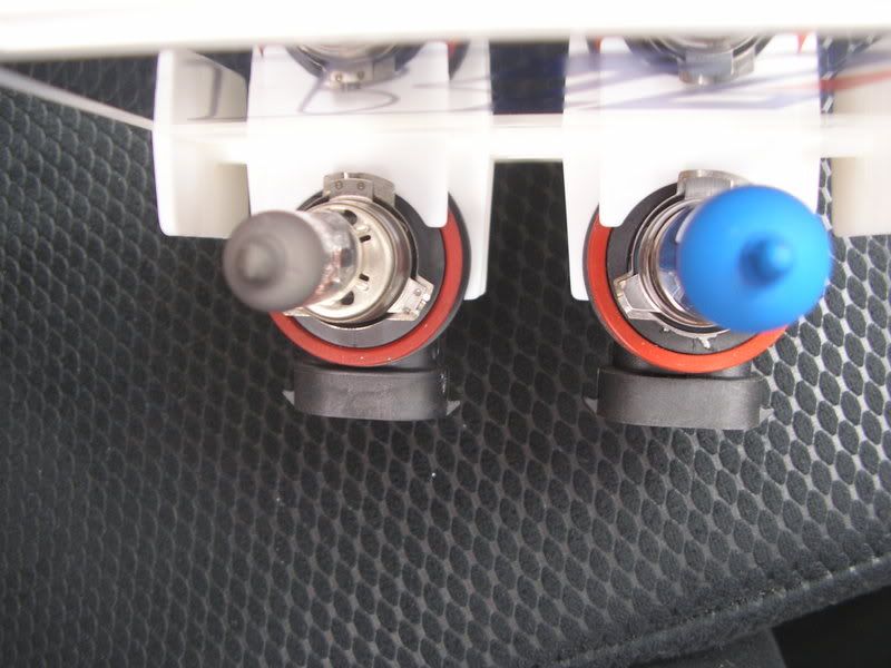

Note the difference in the size from the ones I have chosen. The are larger, but they fit perfectly fine.
The pattern is the same.

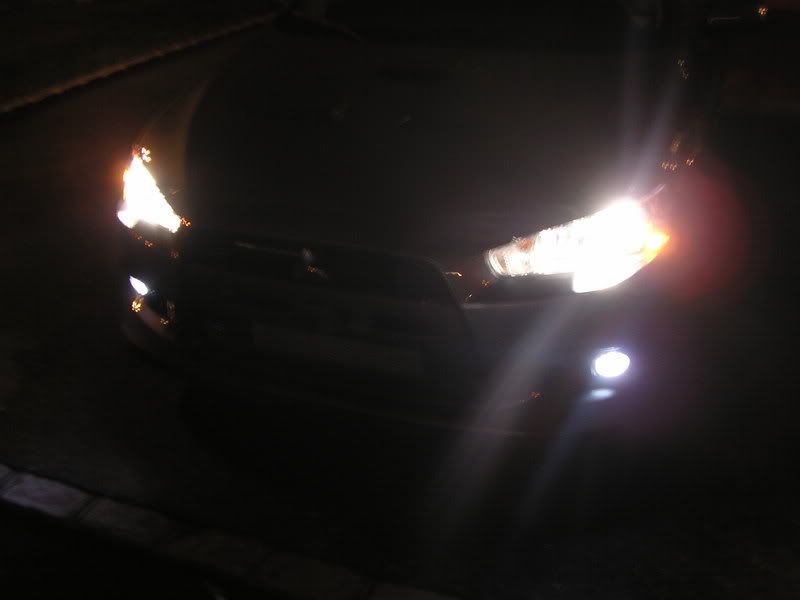

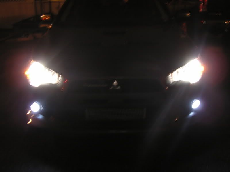

***Sorry Night Pics Suck**

I think I will have to change out the main headlight bulbs to make it match. Or change them out again for yellow. I just did it .... just to do it :) Then I washed the car. OMG brake dust.
