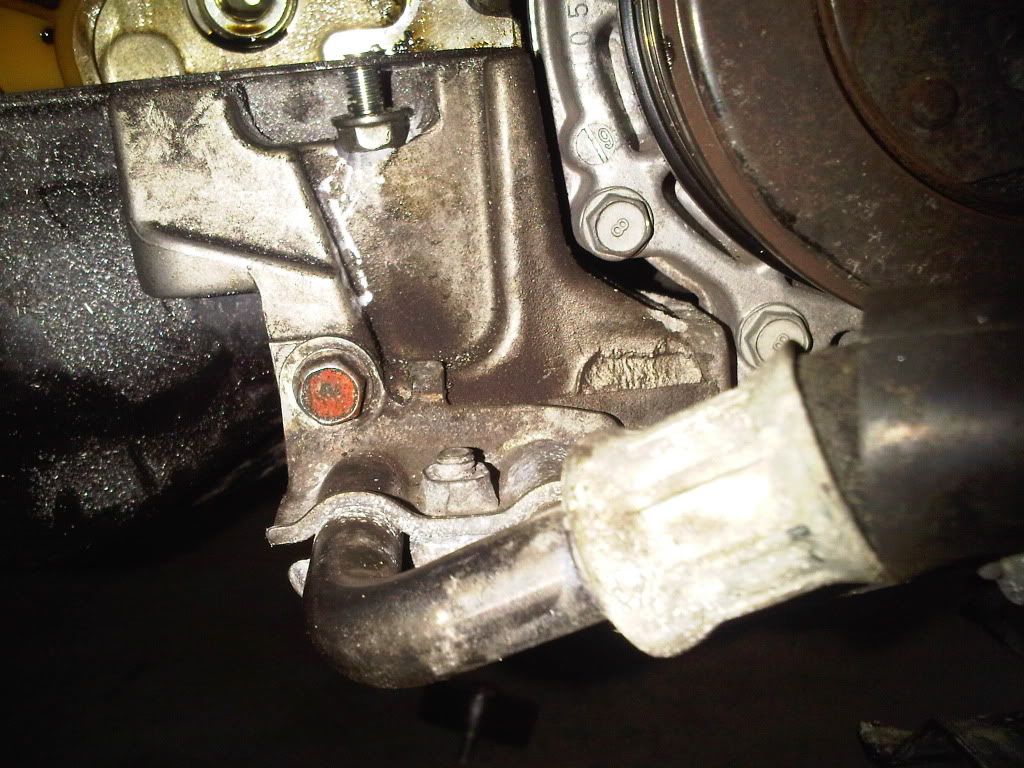

COple things. I shaved the lower bracket to remove front most 10mm bolt from botom of oil pan. I also took off 3 bolts to remove coolant piece off head without taking any of the hoses off.
Can you explain the "Shaved" part a little more? Like the purpose for doing so and what you actually shaved.
Couldn't get the front most bolt out due to the bracket below it> here you can see i Shaved a few mm's off the the bracket webbing underneath the bolt that allowed me to remove.
