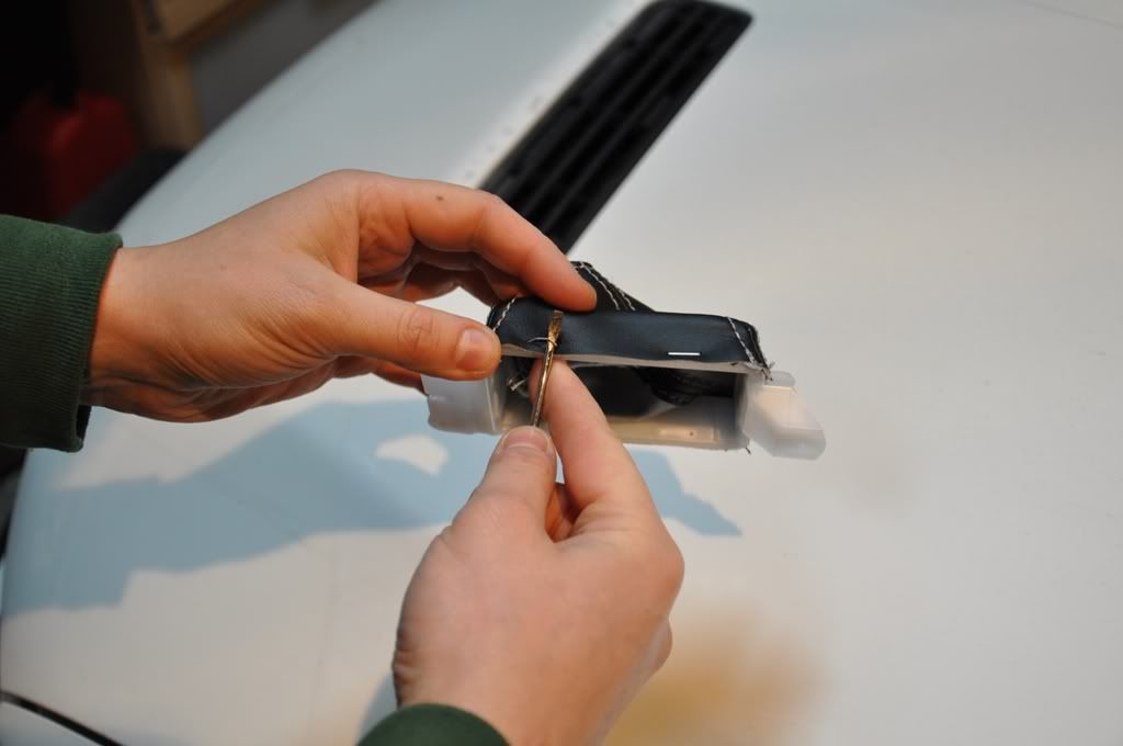

- pliers

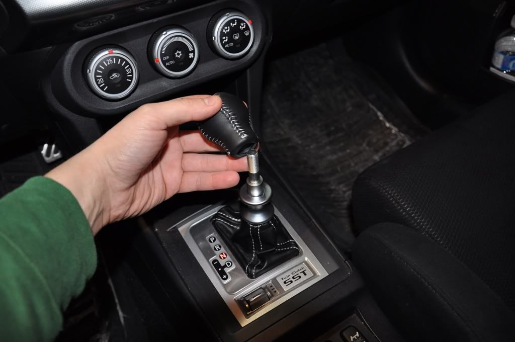

2) Unscrew the shift knob.
3) Unbutton the metal clasp on the upper part of the shiftboot.

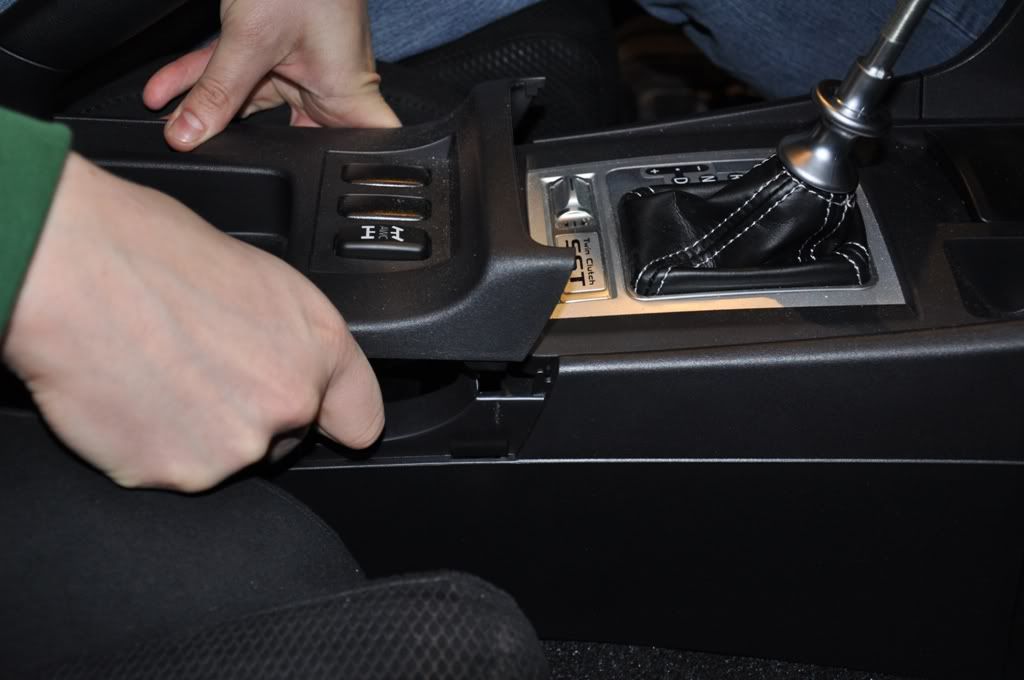

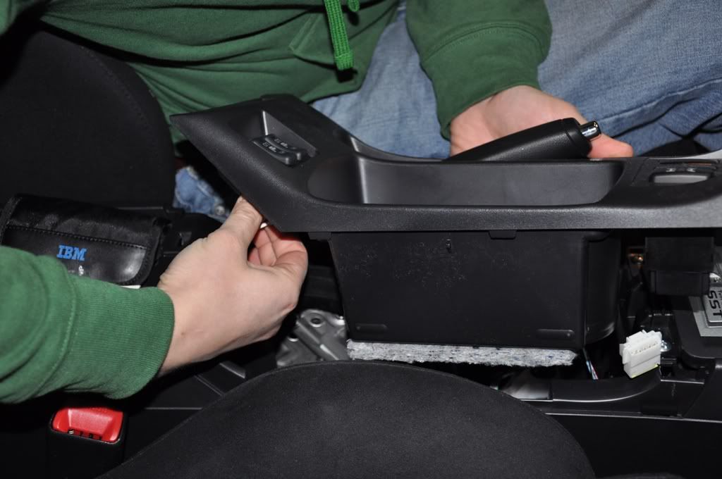

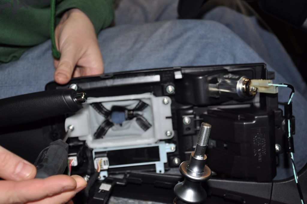

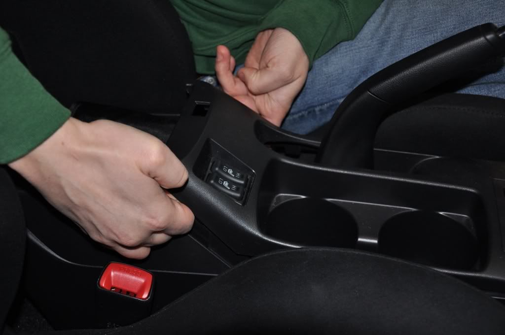

4) Open the arm rest and lift up the centre cup holder console from the rear, then slowly moving forward, pull upwards on the console near the shifter base. There are 4 clips here, ensure you don't loose the two white plastic ones near the shifter base.
5) Unclip the AWC module wires by depressing the white tab.
6) Unclip the heated seat module wires by depressing the white tab, and set the console aside.
7) Unscrew the two screws holding the shifter base in place and set them aside.

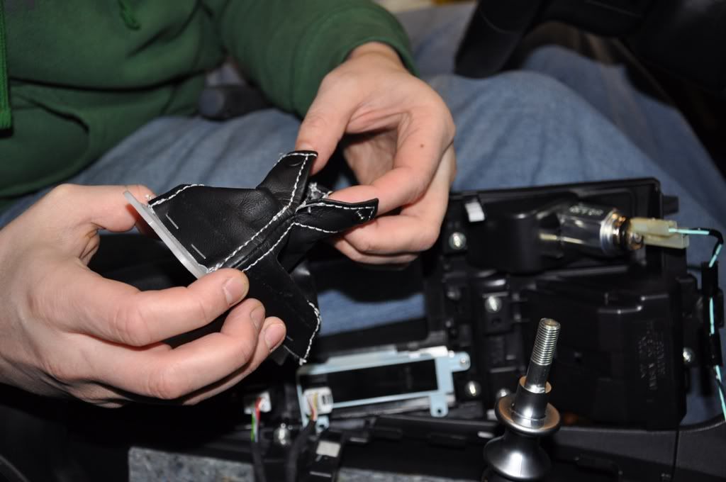

8) Lift up the shifter base and pull it towards you. There are two clips at the front of the base and two sets of wires, so be careful and do not pull too hard.
9) If you have enough slack in the wires unscrew the three screws holding the shifter boot base in place. If your wires are very short, simply unplug the SST control switch and the SST LED indicator module wires and set the console aside.

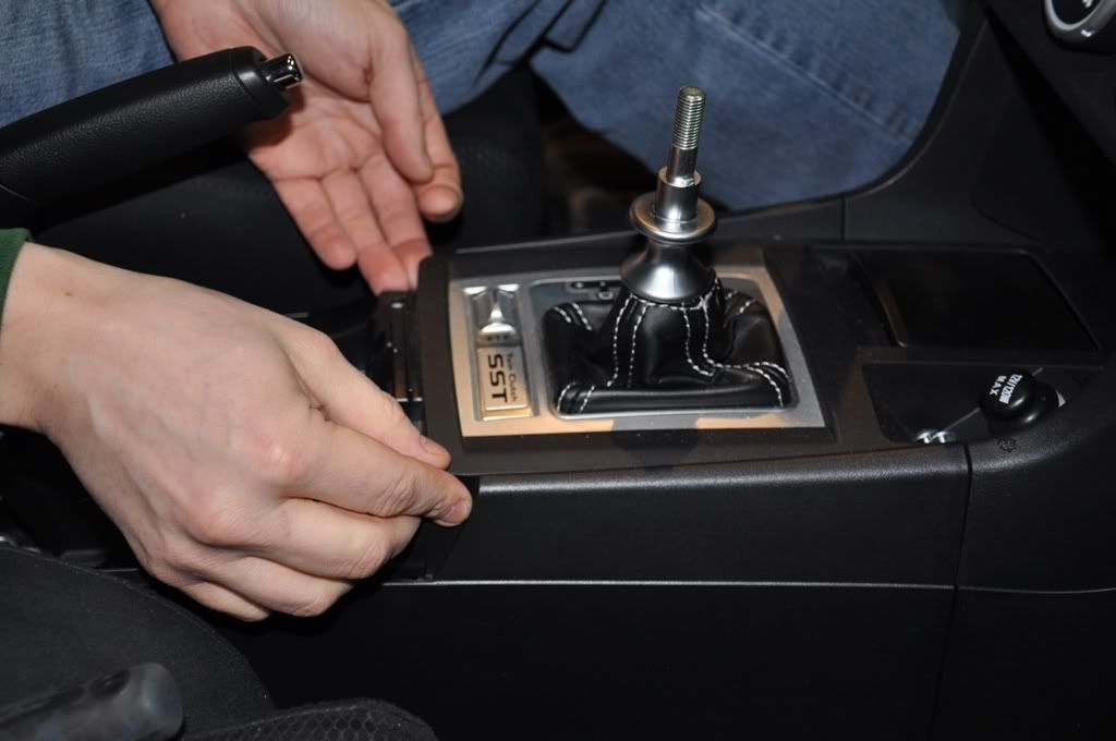

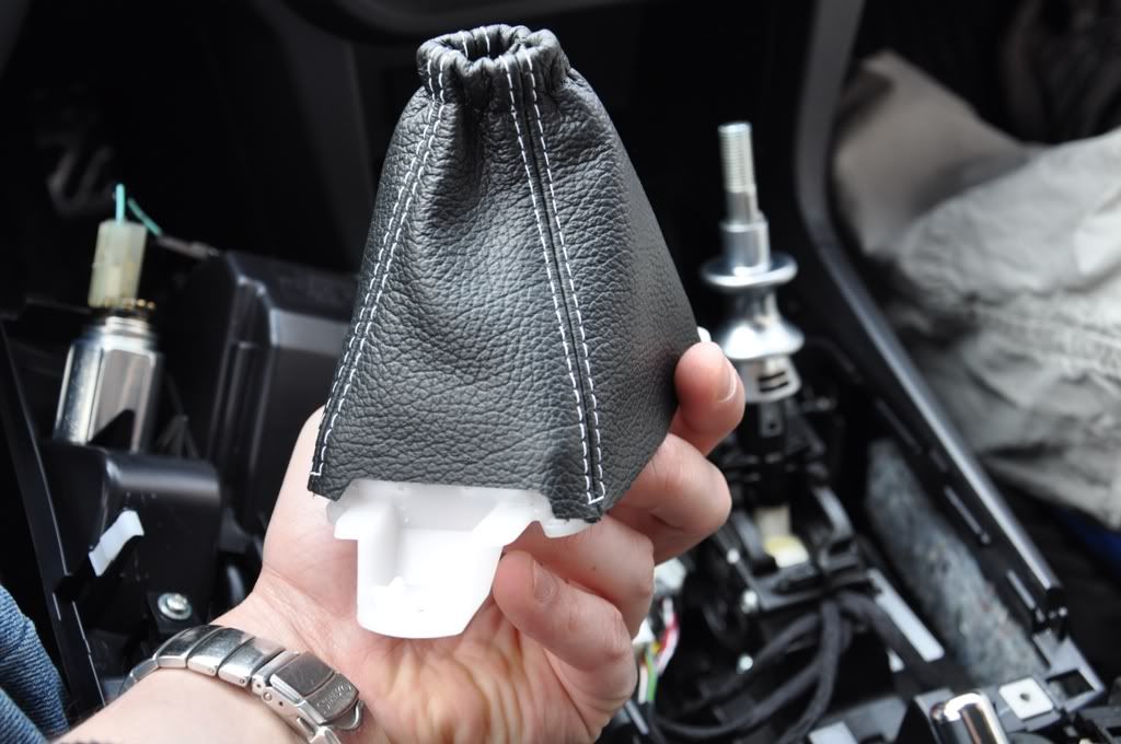

10) Remove the shift boot base from the console and remove the OEM junk shiftboot from the shift boot frame by pulling out the staples.
11) Place your new REDLINEGOODS shiftboot over the shifter boot frame ensuring the cutout goes to the bottom.

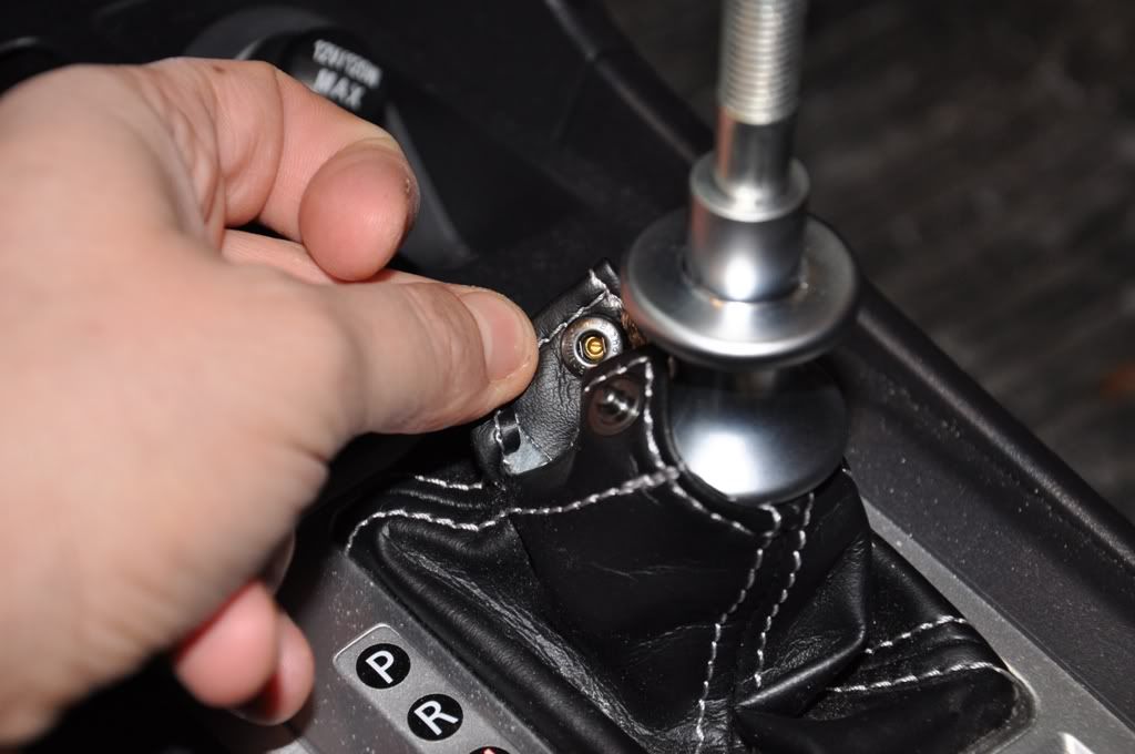

12) Insert the shiftboot into the shift base console and re-tighten the three screws, then pull the shiftboot over the shifter stretching the elastic over the reverse lockout mechanism. The REDLINEGOODS shiftboot uses a durable elastic to strech over the reverse lockout instead of a button type clasp. This approach ensures a better fit and a cleaner looking end result.

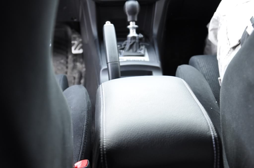

13) Or pair up the shift boot with a padded arm rest for a totally awesome look. :D

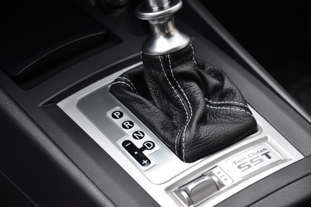

CONGRATULATIONS - YOU HAVE SUCCESSFULLY INSTALLED YOUR NEW LEATHER BOOTS!

I would suggest using a box cutter vs. a screw driver to remove the AWC surround. The box cutter is thinner & wider, which is overall better when wedging into a small area & pulling upward. The box cutters can also be used to remove the staples, if they aren't extremely brittle (then pliers would be necessary).
I actually already have a detailed how-to made up in my FS thread, but here it is anyways. I have taken apart GSR shift surrounds & my MR surround several times. Very easy if you aren't too tender with the plastic. It can be worrisome at times, because of the force involved. It does take about 15 minutes on average, like NEWB was saying

No need to remove the AWC buttons at all, you can scratch those parts and that would not be cool.
If you simply lift up on the back part of the cupholder console it will pop out, simplifying the install that much further.

True that it's not 100% necessary, but the box cutter fits nicely between the cup holder section & the plastic AWC surround. It gives a nice firm area to grip, when pulling up on the cup holders. In my BF's GSR & in my MR, we always pop that little plastic area out first, since the cup holder section get stuck in there pretty well. & no scratches on the little rectangular piece.

is that a bad thing? This one was made as direct replacement for her OEM shiftboot and to match the padded leather arm rest. I will say it turned out faaantastic. :D also its made from 100% genuine leather, not the fake plastic junk. Ask anyone about the quality of Redlinegoods stuff, nothing but positive comments.
I have been using their products since 2005 and just recently sold the shift boot from my Maxima. It looked as good as when I first got it in 2005 :yay:
