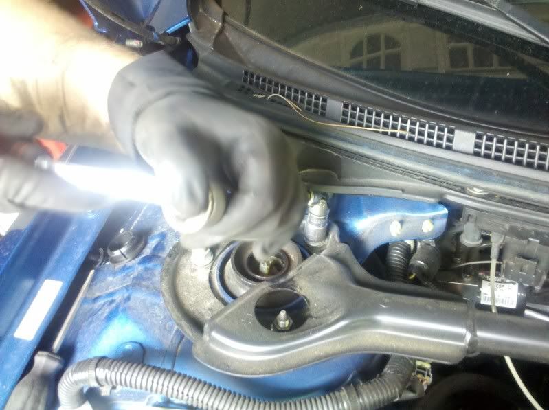

Two of the bolts are easily accessible. The 3rd one you can't fit a deep wall socket in there. I saw this pic and it looks like they are using a regular socket with a flexible extension but with a regular socket the socket doesn't fit deep enough on the nut. Is there a different socket I'm missing?

I used a ratcheting box wrench. Worked fine for me several times. The new Craftsman socket/ratchet set will work fine as well, the one with the pass through design.
Some remove the plastic piece...up to you really.

Take out the two (per side) push-pin retainers on the plastic trim strip on each side. that covers access to the rearmost bolt - the part your gloved hand is resting on. Then lift the black trim strips up - there's now plenty of room to use a semi- or deep socket and rachet.
BTW - those nuts go back to 35 Ft-Lbs.

I used a breaker bar to get it started then just a crescent wrench. Worked just fine.

If you leave the other two bolts tight, remove that one first that way when it's broke you can just spin it off with your fingers... Get a wrench on that

I would have said use a wrench. That's what I have used to remove nuts. Sometimes I will use a socket too.
