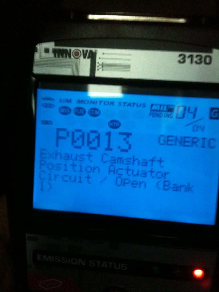

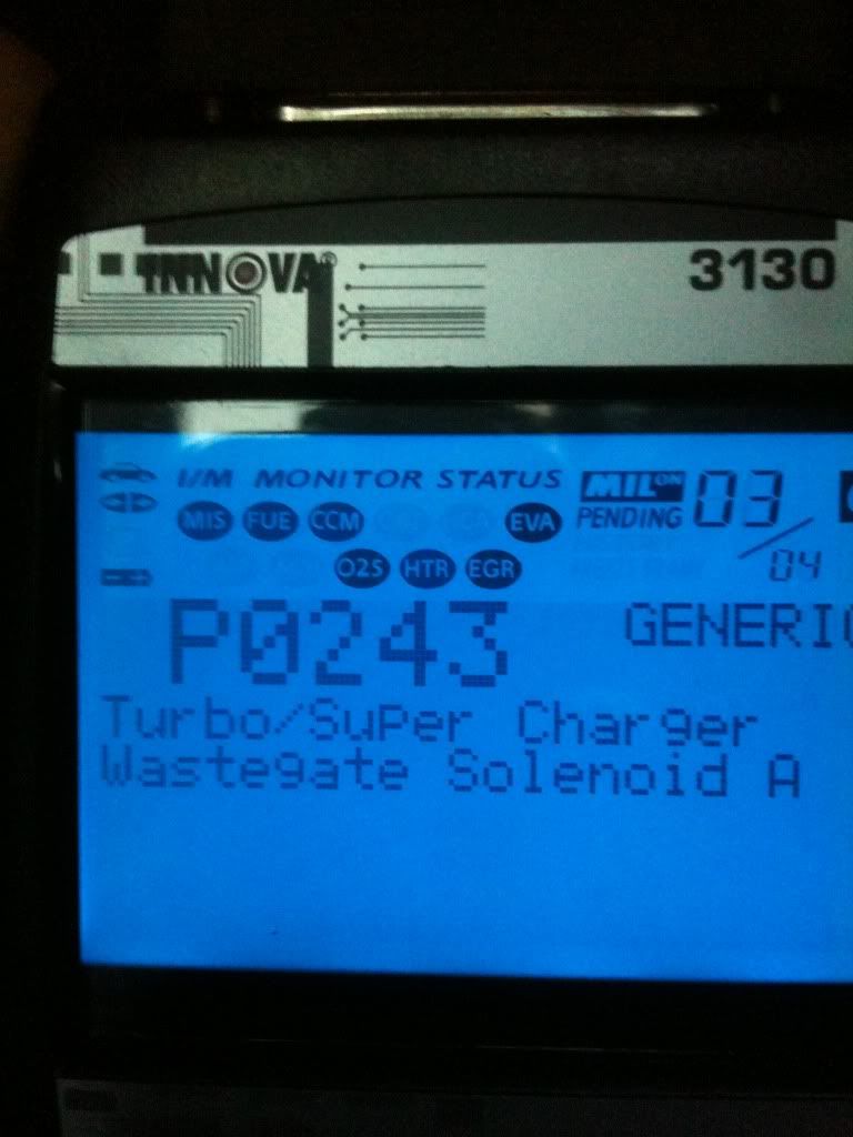

I have not had time to get this looked @ as of yet, thought I would share. I hope its just the cool weather setting off these codes but im still unsure, every time I drive my car these come up

a code for an open circuit doesn't sound like it would be weather related. Have you checked all your connections, such as the one to the exhaust MIVEC solenoid?

just noticed my BCS was plugged in backwords, guess my tuner switched it.. oh well, took the car out for a 20min rip and im still getting a code 0013, but seems the other one went away!
