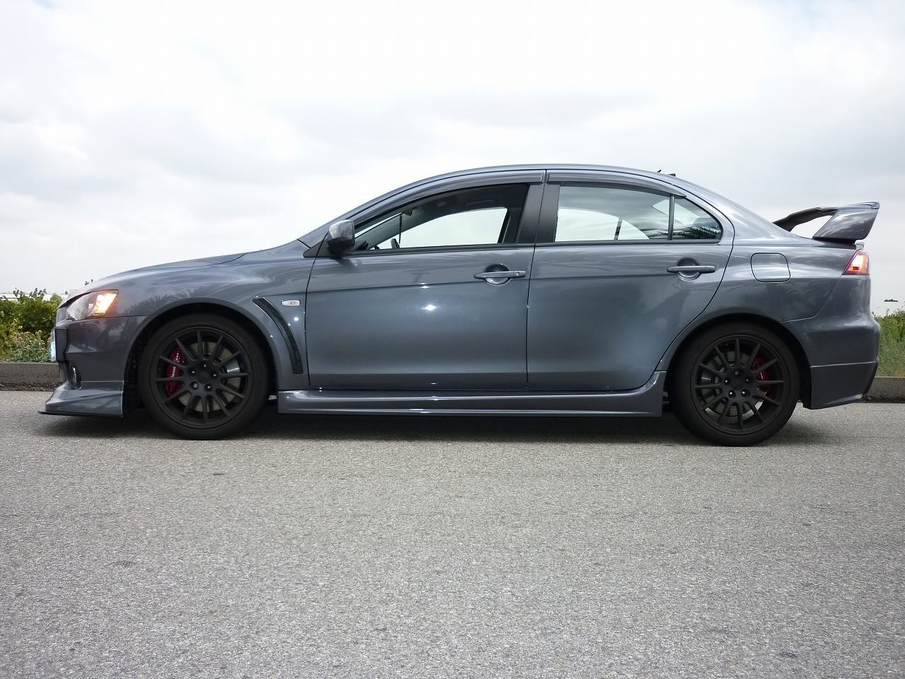

Here are the before
and After
Now these are the pictures right after install. So it is sitting higher and it’s already lowered a noticeable amount now. The reason being the top hats have a rubber portion the spring sits on. The rubber needs to be reseated with these springs. I expect it to be fully broken in, in about a full tank of gas.

do you have more pictures of your car from other angles? id like to see the rest of it
aka TJs98GT
589 Posts
Which angle? I will take whatever you want. I figured this angle shows the drop the best. I know its kind of hard to see with this lighting and the color of my car and wheels.
i wanna see your front corner view so i can see the front lip and a view from the back corner but higher up so i can see the cf lip spoiler and vortex generator. i think its the same kind of ideas i wanted to do but hard to tell
103 Posts
It's not carbon and it's a Voltex front lip. And I will take snaps of it when I can.
