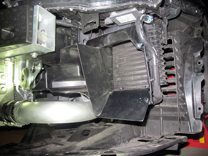

I think every small details play some role in keeping it cool. Fog light delete, upgraded cooler(AMS/SSP) better airguide(i did mine), tranny oil. left foot braking(another culprit)
Do you have a picture of your airguide? I just removed mine entirely. I cannot imagine how any of the stock nonsense aids in anything.
He was definately running more aggressive 1:34 laps vs mine 1:43. He has drop in + exhaust and tune. I have aem intake, exhaust, e85. I've got more hp. I was not left braking. we both ran in ssport mode. I used paddles and w/ out. I think maybe I have too much sst fluid. Maybe contributed to the fluid leak?
Sent from my DROIDX using Tapatalk
not mine but almost exactly the same....i think im the 2nd one.
Interesting. And obviously you've seen an improvement with this set up?
is the airguide commercially available?
