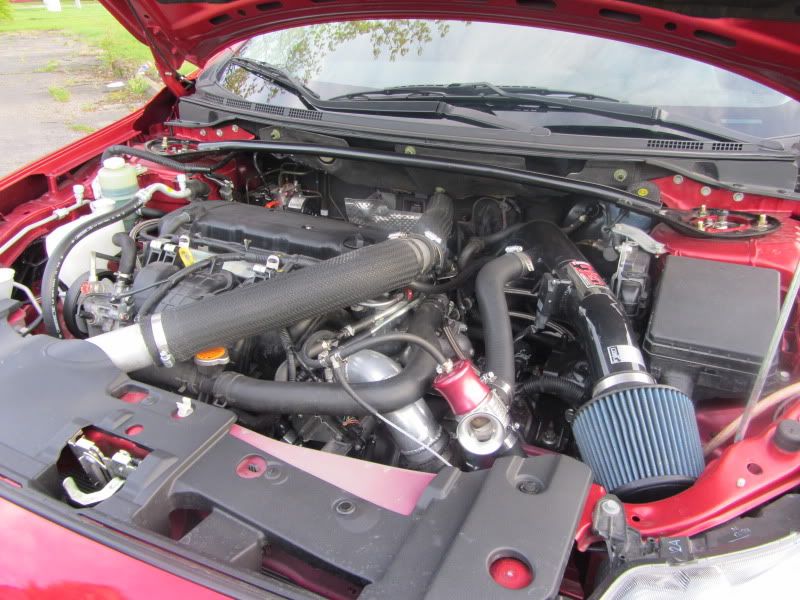

I like it, got any engine bay pics rolly?
a friend of mine has a DE lancer a total sleeper no wing no side skirts it even had the stock hubcaps and he installed all the X turbo parts he made 253whp and was giving a run for my money before I tuned my X I was impressed of what it was capable of with just our stock parts :shades:
Yeah I got some pics kicking around.
I did this build when it was very very very new to Lancers. If I wouldnt have gotten the Evo I would have had this cleaned up alot better. Hard UICP, different intake and move the battery back up front. But yah, this was pretty much the setup for about 6 months
