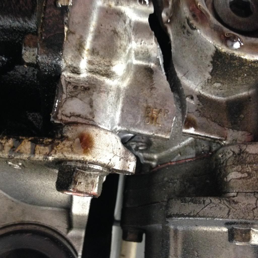

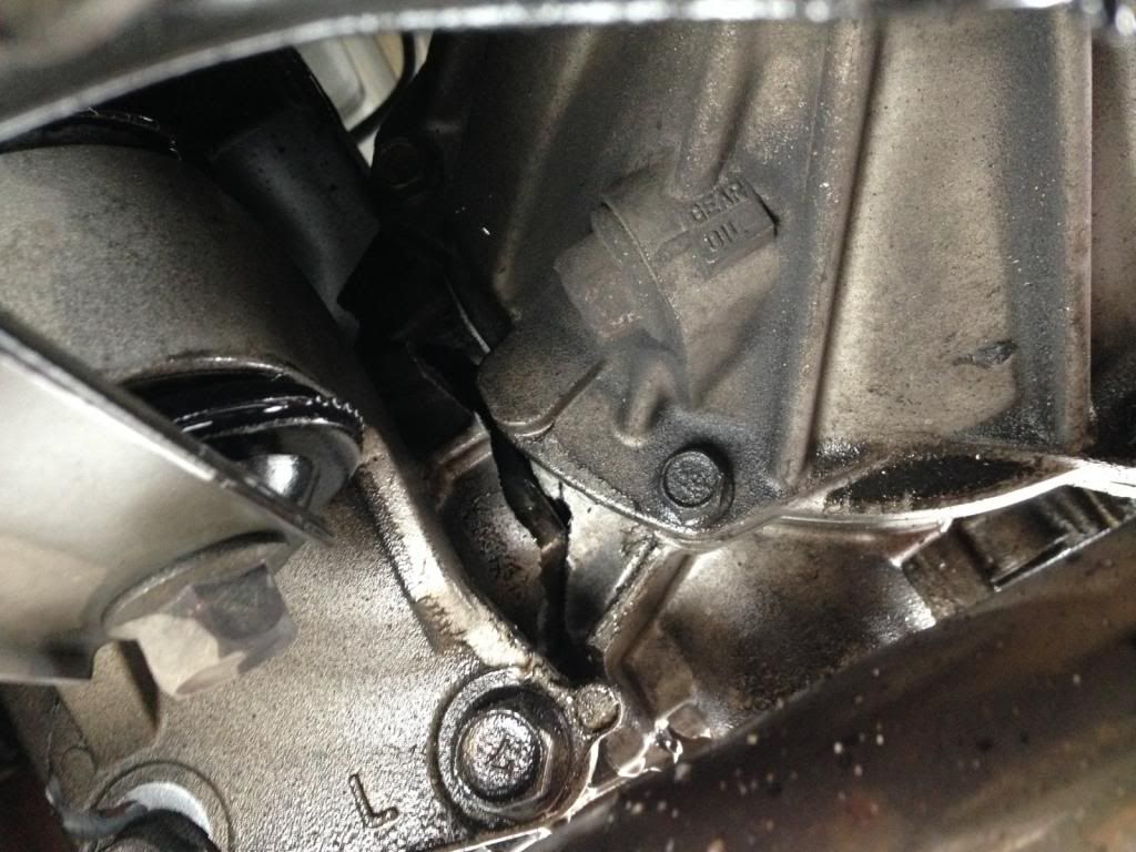

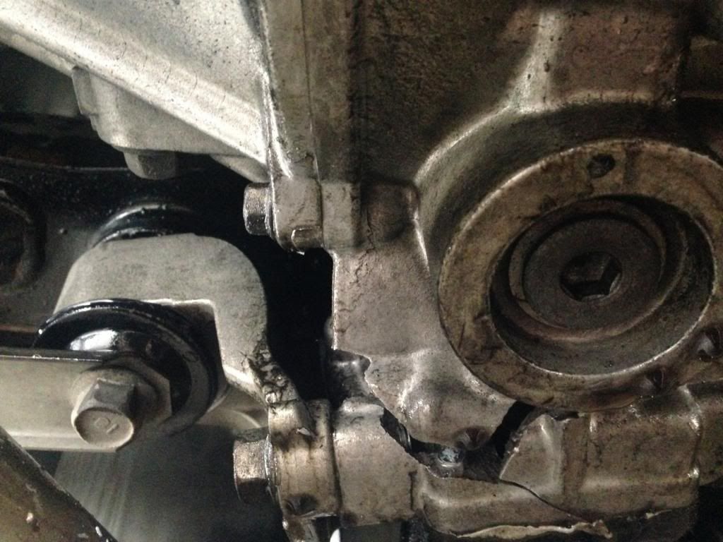

Well after a long process of getting a trailer and getting the car home I finally got underneath and saw the damage:
Well now that I know I have to replace/fix my rear diff... What do you guys recommend? I want to be able to launch my Evo at the drag strip still, but I am terrified of this happening again! I've heard of people doing a 8/9 swap, maybe that's a good idea? Or just getting a used one and putting better bushings and things in it? Or trying to send it to Jack's Transmissions to see if the can fix it still? Their ad says they can do it even if it is cracked, although I think I completely snapped mine in half!

Holy shit! Now that is how you break a diff. Forget cracking, leaking. Blow that bitch in half!!! lol.
So when you are launching the car... Do you just hit the gas and let the clutch go? If so, I would recommend letting the clutch out slightly until you feel the grabbing point, then smoothly letting the clutch out the rest of the way.
Either way sucks that this happened. But man if you are going to break something, don't half ass it, go all out like this!! lol.

Damn that sucks. Sorry to say but this is a simple case of driver error, not the 7000rpms. You clearly didn't preload your drivetrain and just dumped your clutch. You should have been taught how to do this before trying. The fact you didn't know it would build boost means you didn't know what you're doing. Expensive mistake.
