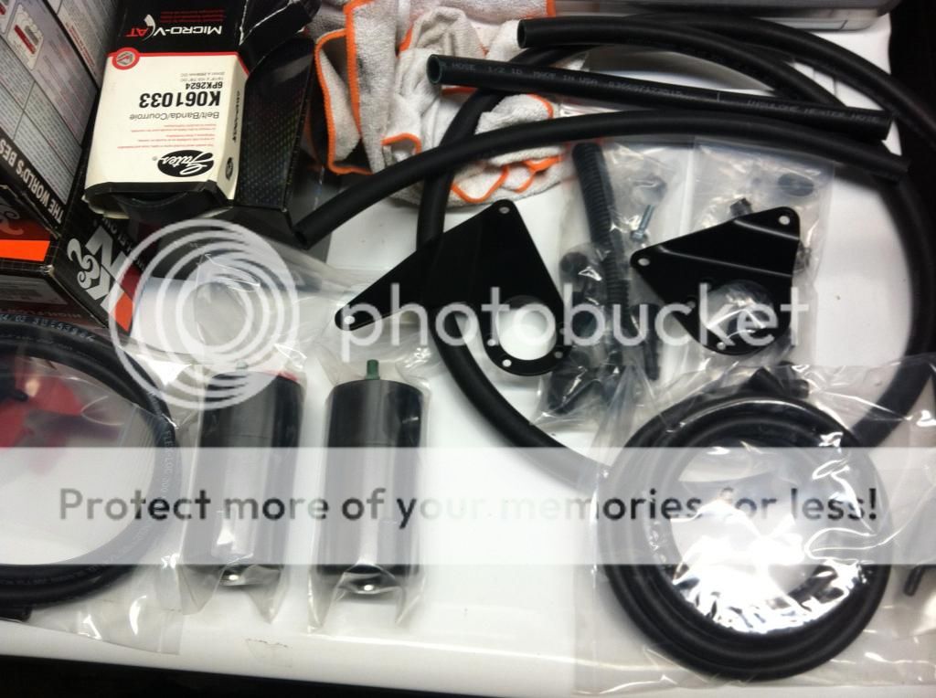

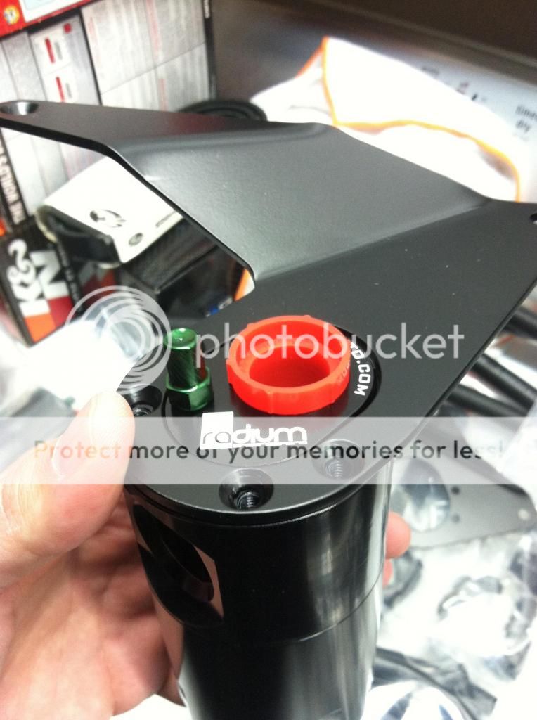

Big thanks to these guys for a awesome product.. almost ready to install. Overall quality and craftsmanship is superb. 2 drain kits included as well.

Nice - looks great... build quality is pretty slick. Esp when u unscrew the can and the baffling system is a extruded hollow of the radium logo w/ multiple screens.. At that point I was like, ok -this is cool.
