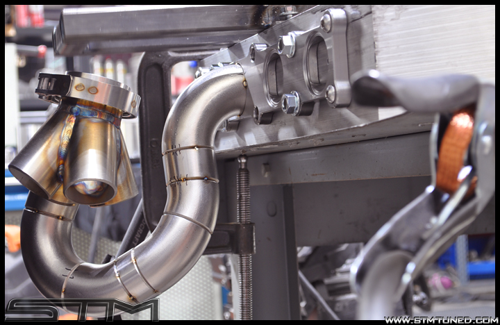

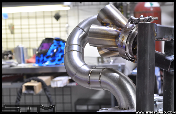

There's still finalizing to do and some heat wrapping or shields, but it's coming along. We will have it all installed and on the dyno for testing soon!
I've had really good luck with just the DEI heat reflective tape keeping the heat off my plastic composite valve cover. The red engine cover might need a bit more to keep it from melting but ceramic coating the DP/headers and putting a DEI T3 Turbo blanket should absolutely make it fine. I also fabbed up a heat shield that deflects radiant heat from the cam sensor and a bit more of the DEI heat reflective tape seems hold up even for 30 minutes of road course driving with my full race manifold. Rear heat shield will probably also need a boost depending on what you are using it for. :thumbup:
The fabrication looks great and I can't wait to see what kind of numbers it will do. If you get to a T4 version that will work with the EFR7670 or similar I'm sure I would be interested.
