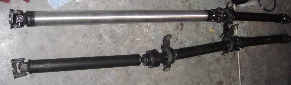

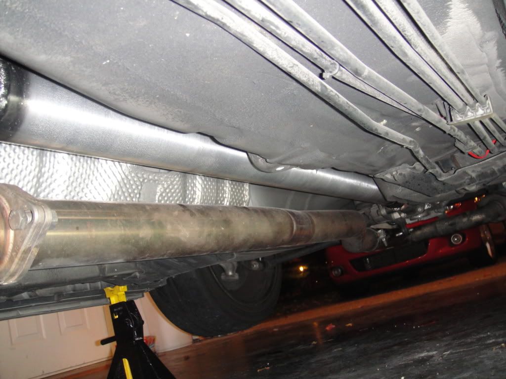

Two days ago I was lucky enough to finally install my AWD Motorsports Driveshaft. The installation was pretty straight forward and required no removal of other parts (with a cp-e exhaust), though you might need to remove yours if you can't work around it. Installation was also possible with just myselfand the car on floor jacks. This item definitely frees up some power, no matter if your setup is maxed out (out of injector here) or not. found that the weight difference is 15lbs between the two of them... just like AWD advertises. The aluminum driveshaft piece replaces the rear 2/3's of your factory unit and eliminates another universal joint in the system.
Gains- as of now I have no numbers to back up gains, but it feels that my pump tune picked up another easy 20whp. I also noticed the car accelerates easier while doing normal daily driving too. All in all I would buy this item all over again if I could. The VIII and IX guys love these things, and I am sure all the X owners will too.

They just started making them and I was fortunate enough to get the first one (guess it is because I have been bugging them so long to make it). I would be willing to bet that it makes power because the older Evos are picking up 3mph in the 1/4... so the gains are definitely there. As far as warranty, I am not sure what it is but, if this is ran on the Bad Bish, Ricer, and AWD's RS, and I believe the Bastard too, I don't think there is much to get warrantied (pretty solid part).

The whole shaft gets sent to you and you send yours back. The front section is different from the factory unit because it has a damper/chassis mount on the first section of AWD's shaft.
