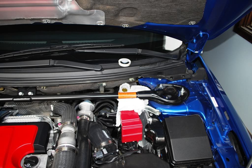

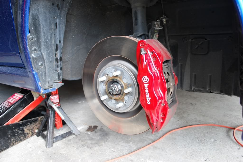

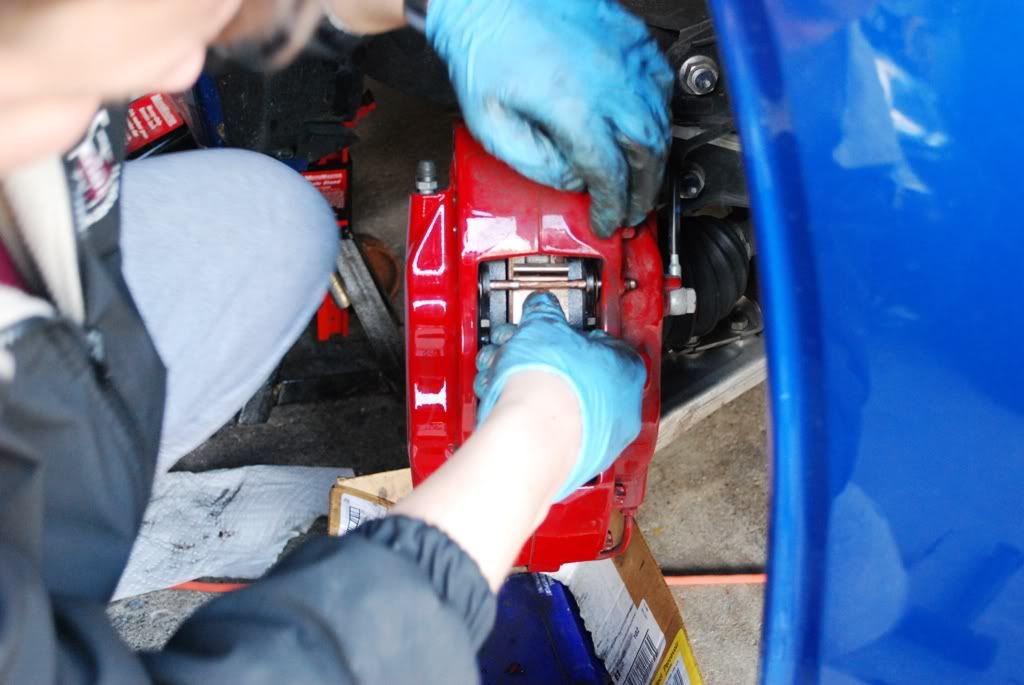

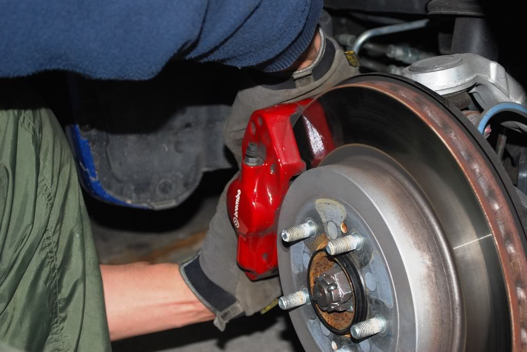

1) Jack up the car, and remove the wheel your going to be working on and open up the brake fluid reservoir.

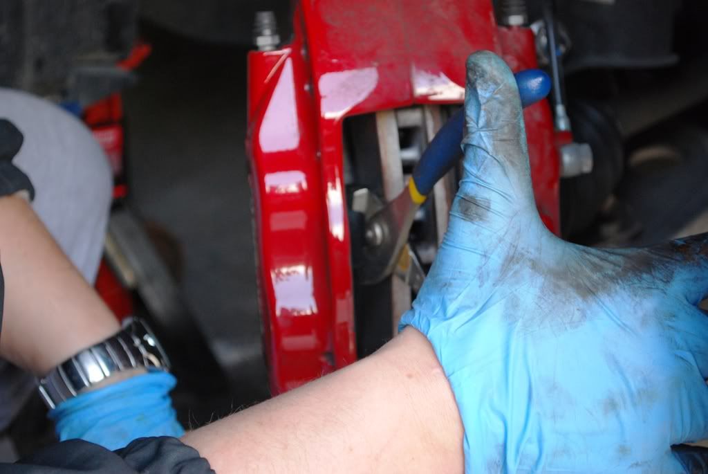

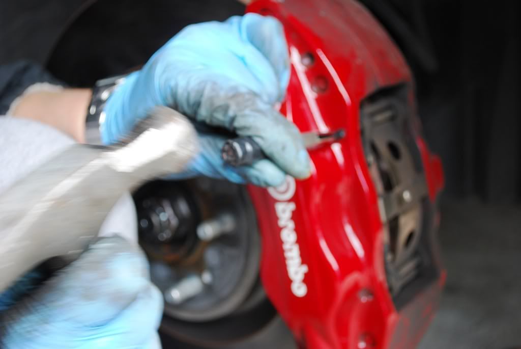

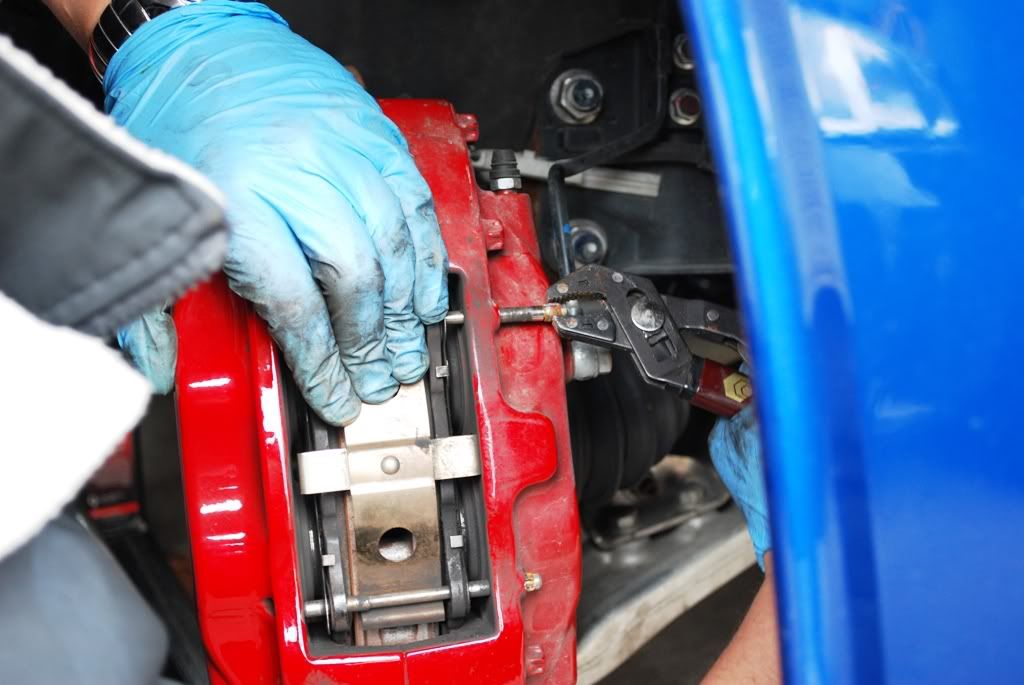

2) VERY Lightly hammer the retainer pins until they hide into the caliper body.
3) Using a set of vice grips or pliers pull on the retainer pins while pushing on the spring loaded clip, start with the top one first.

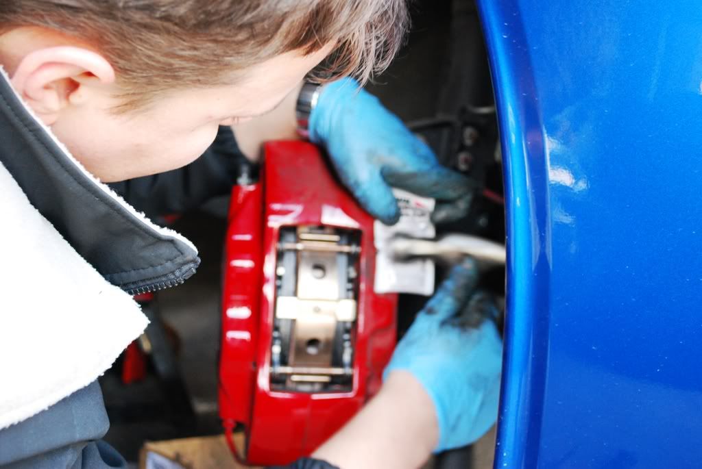

4) Once the top pin is out, slide out the spring loaded retention clip and remove the lower retainer pin.

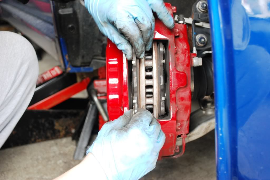

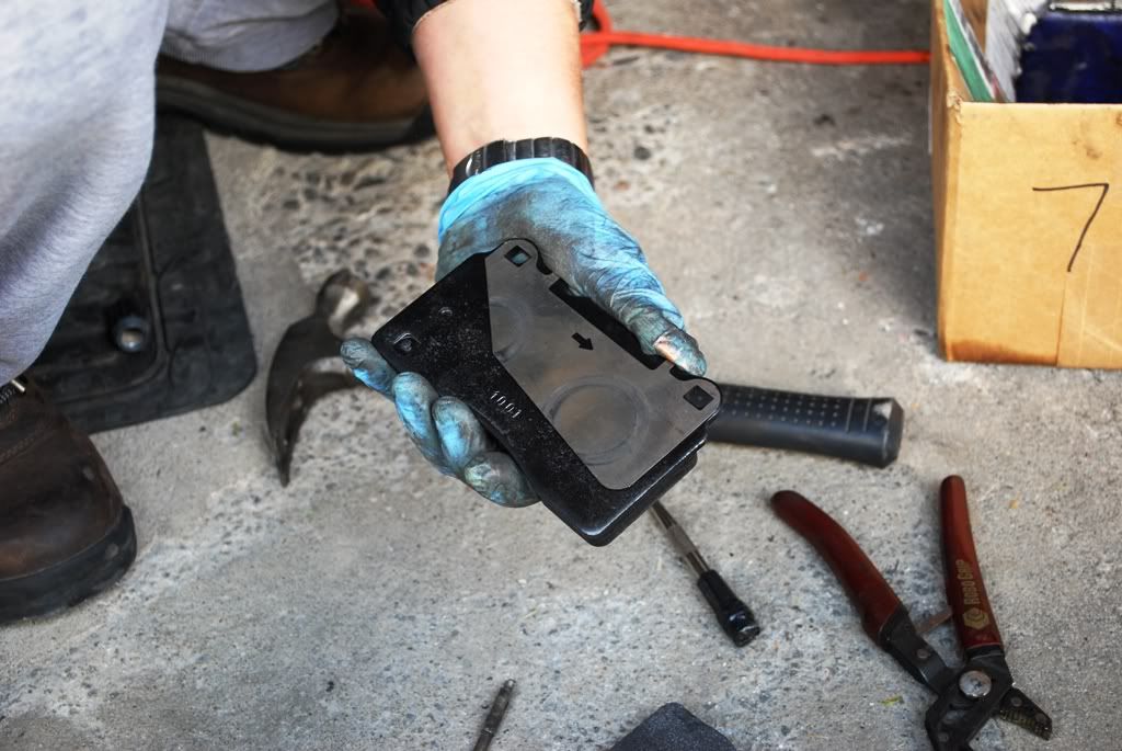

5) Slide out the outboard side pad first and remove the metal backing, you will reuse the backing once you clean it, also clean the spring loaded retention clip and pins.
5) Slightly burnish the new pads with 800 grit sand paper (NOT REQUIRED if you will bed the pads in slowly)

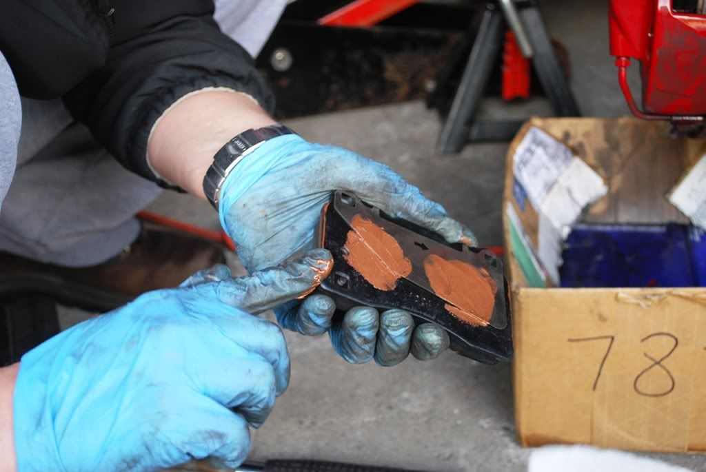

6) Place the backing on your new pad and apply brake caliper grease to the round circle areas, to the top and bottom of pad edge and to the front small indent.
7) Push back the outboard pistons with pliers if you don't have a fancy caliper spreader. Also slightly grease your retention pins.
8) Repeat the above procedure for the inboard side pad, then replace the lower retainer pin and spring loaded retention clip.
9) Putting pressure on the spring loaded retention clip slide in the upper retention pin back in.
10) Hammer the retention spring into place until the back is flush with the caliper body. I used a piece of plastic to prevent the hammer from scratching the caliper paint.
11) Thats it you are done...........one wheel LOL
12) Repeat for the other three wheels, close the fluid reservoir and then tidy up your work space.
13) Slowly test your brakes and follow manufacturers bedding in procedure and ENJOY your new stopping power
